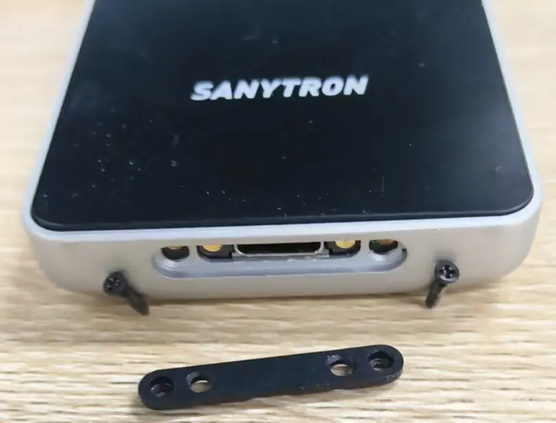

1.1 Locate the Protective Cover
At the bottom of the remote, where the charging pins are located, there is a small protective cover.
1.2 Remove the Cover
Carefully use a small screwdriver or pry tool to gently remove the protective cover. Underneath, you will find a USB-C port.
⚠️ Caution: Be gentle when removing the cover to avoid damaging the remote's housing.

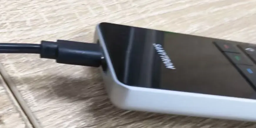

1.3 Charge via USB-C
Connect a standard USB-C cable (from an Android phone charger or similar) to the port and charge the remote.
Diagnose the Result
- ✅ If the remote charges normally via USB-C: The battery and internal charging circuit are working correctly. The issue is most likely related to the charging dock or its contacts.
- ❌ If the remote does not charge via USB-C: The issue is likely with the remote's internal hardware or power management. Please contact Sanytron support for further assistance.
💡 Tip: If the remote charges to 100% via USB-C, this confirms the battery and charging circuit are working correctly. We can then focus on troubleshooting the charging dock.
