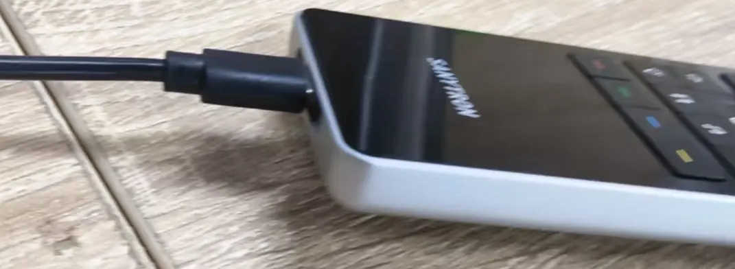

Option 2 — USB Type-C Cable
Astrion also includes a standard USB Type-C charging port. The connector is hidden beneath a small protective cover on the bottom of the remote.
No charging dock is required — use any standard USB-C cable.

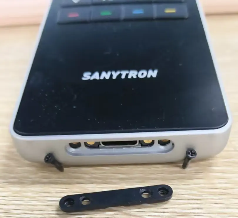

Access the USB-C Port
1 Turn the remote over
2 Locate the small protective cover at the bottom
3 Remove the two small screws using a precision screwdriver
4 Lift off the protective cover
5 Connect a standard USB Type-C cable

⚠️ Important — Keep Track of the Screws
The two screws that hold the protective cover in place are very small and easy to lose. If the screws are lost, the protective cover may not sit flush against the remote, which can cause the remote to wobble or not sit properly on the magnetic charging dock, affecting charging stability.
  • Work on a clean, flat, well-lit surface to avoid losing the screws
  • Place the screws in a small container or magnetic tray while working
  • If you lose a screw, contact Sanytron support for replacement
⚡ Once the cover is removed, you'll see this:
Protective Cover Removed USB-C Port ┌─────────┐ │ USB-C │ └─────────┘
The charging dock uses the two pogo pins shown above, while USB charging uses the hidden USB-C connector. Both methods charge the same internal battery.
⚠️ Caution: The screws are very small. Work on a clean, flat surface to avoid losing them. Be gentle when removing the cover to avoid scratching the remote.

If Astrion does not appear to charge on the desktop dock, try charging it directly with a USB Type-C cable.
1 Remove the protective cover
2 Connect a standard USB-C charger
3 Wait several minutes
If the remote begins charging normally, the issue may be related to:
