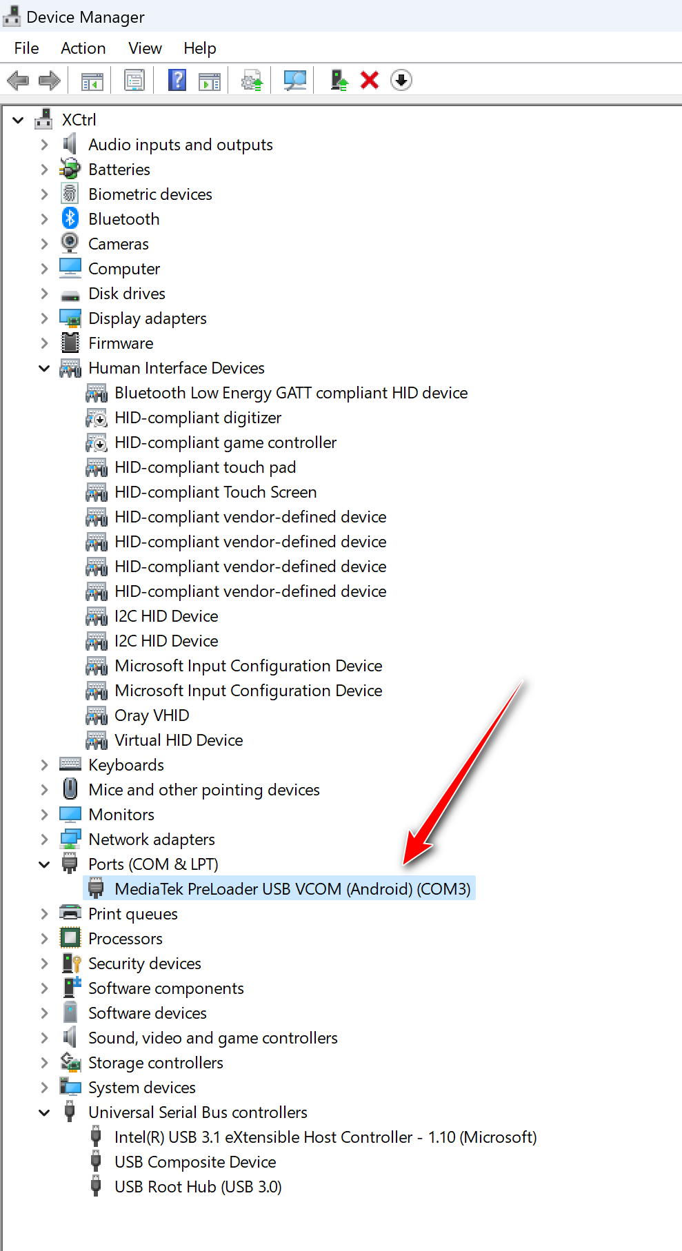

Verify Driver Installation
Connect the Astrion Remote (powered off) to your PC using the USB-C data cable. Open Device Manager and verify that the MTK USB driver appears under "Ports (COM & LPT)".
Tip
If the device does not appear in Device Manager, try a different USB port or cable. Some USB cables are charging-only and do not support data transfer.
