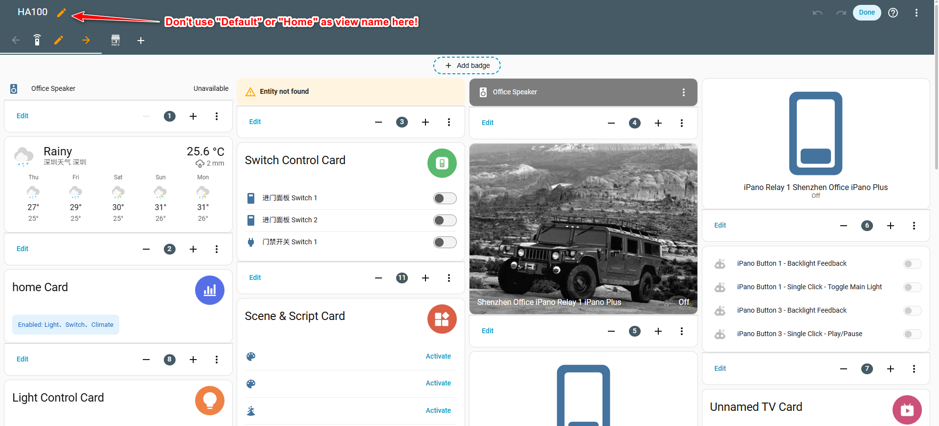

⚠️ Step 5.1 — Check the View Name (Blank or Conflicting Names)
This is one of the most common causes of "Device is Empty" that is often overlooked. If your dashboard view has a blank name, or uses a name that conflicts with Home Assistant's built-in views, Astrion may not be able to sync it.
What Counts as an Invalid View Name
  • Blank / empty name — The view has no name at all (most common issue)
  • "Home" — Conflicts with Home Assistant's default view name
  • "Default" — Reserved by Home Assistant and may not sync
  • "Overview" — Also used by Home Assistant internally
⚠️ Critical: A view with a blank name will not sync to Astrion, even if it contains valid RosCards. This is because Astrion identifies views by name, and a blank name provides no identifier.
How to Fix a Blank or Invalid View Name
  1. Open your Home Assistant dashboard in a browser.
  2. Click Edit Dashboard (pencil icon, top right).
  3. Find the view tab you want to use with Astrion.
  4. Click the pencil icon next to the view tab to open view settings.
  5. Enter a unique, descriptive name in the Title field.
  6. Save and exit edit mode.
  7. On your Astrion Remote, pull down to Refresh.
